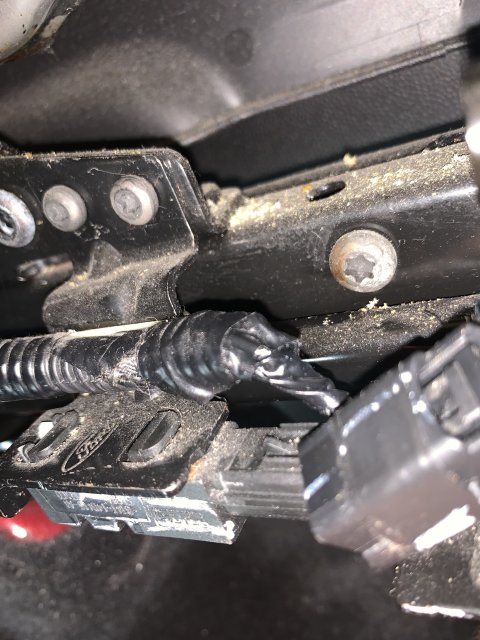

My airbag light is intermittent On my 2013 Fiesta. It resets at start up but when I’m the car reaches around 10 mph, it comes on. I think the problem is on under the seat on the driver’s side. The car still has stock seats. I believe the issue is with the seat position sensor. Has anyone else experience this?

It looks like the connector for the sensor is disconnected in that picture. I'd say that could definitely be an issue.

Usual culprits would be a ground/short or a fuse. But if a fuse blew I'd be asking what caused it as well. Faulty part?

Do you have a scan tool that does SRS? The Safety Restraint System will throw codes and they can be read with a correct code reader that has the program...FYI
