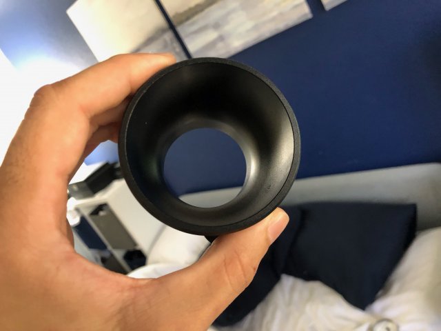

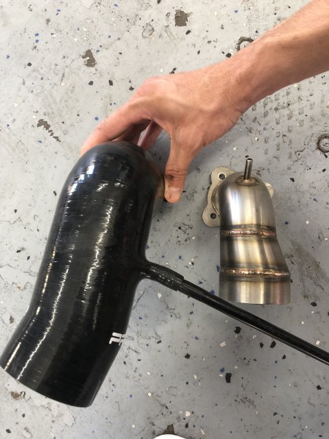

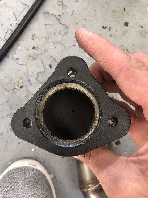

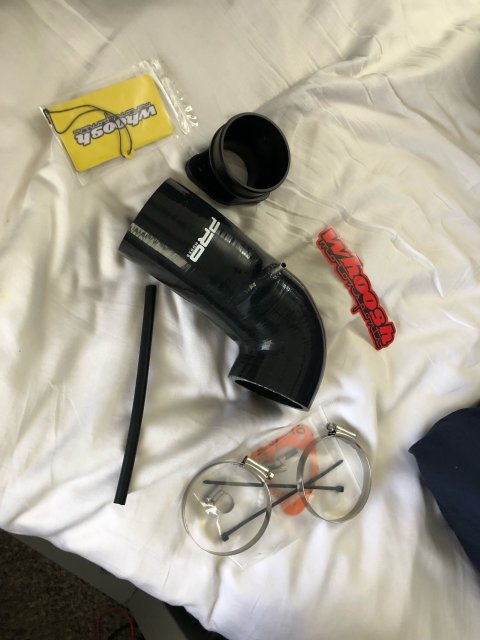

Alright the part is here! Very nice piece and actually very well thought out too!
View: https://youtu.be/PbCTnenDPa8
Here's a couple photos and one especially of the smooth taper on the inside of the inlet.
