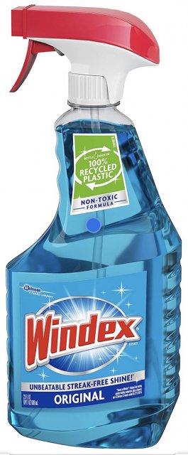

Re: battery terminal corrosion aka white gunk.
This gunk is a catalyst to poor battery performance and corrosion to the surrounding area, the negative terminal in my case. It’s best to take care of it asap. I’ve been managing this for several years now on the FiST with the flooded OE battery. Along with routine cleaning, I’ve tried various terminal protectants and in my case I’ve found that sticky silicon brake caliper grease works best in keeping the gunk from mushrooming out of control, if at all.
