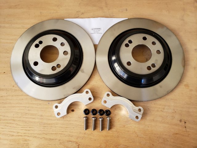

Got a chance to see and hold the 302mm rotor adapter brackets today in the palm of my hands and see how it looks on Dave’s car with the rotors. The brackets are nice quality machined aluminum pieces made to adapt the rear rotors from the Focus RS.
2016+ FoRS rotors? I’ll be checking the Goldcoast site frequently for pricing. My SVT setup works better than stock with my Stoptech BBK but these might compliment them even more. Hopefully the brackets are reasonably priced. The SVT brackets have gone crazy.

I should have taken some pictures, not sure why Dave doesn’t. But I think I read somewhere he doesn’t use his cellphone much or post pics. Looks wise, the 302 fills the space well and looks like business. Dave could probably comment on the performance, since a set is on his car for R&D. He was raving about them.

Does this help?
This is the Rear 302 mm BBK with standard rotors.
Mine are optional Drilled and Slotted rotors.
I know they will sell the kit without the rotors.
However, the rotors must be drilled as they come 5x108 for the FoRS and need to be 4x108 for the FiST.
Drilling can be done by any machine shop.
Gold Coast Automotive will drill them for free, if the rotors are purchased as part of the kit.
Please contact Mark at Gold Coast Automotive for current price, rotor options and/or further details.
