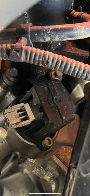

I recently purchased a 2015 ST, love the car but the previous owner did something to what appears to be the stock blow off valve, it’s just to loud for me. Looking for advice on another valve or any ideas on what he did to this stock one to make it so loud.

Does it sound like air brakes constantly going off on a large truck?
Probably installed a BOV spacer. It can be removed and the factory recirculating valve will function like normal.
Edit: the pic just loaded. i dont see a spacer. Is it leaking boost? Swap out for new recirculating valve and see if it still makes loud noise.
