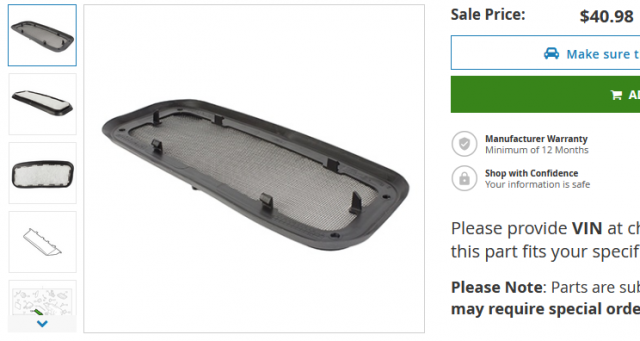

Interesting.
They try to limit the amount of snow intake with a screen, part# D2BZ-18D395-B.
https://www.oemfordpart.com/oem-parts/ford-screen-d2bz18d395b
Looks like they still fall well short of screening-off the entire reservoir. I guess they're reserving that for the next TSB when someone's drains get clogged. (wishful thinking)
