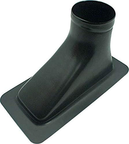

The issue I have is trying to find a 2" intake to mount to the front airdam. All the intake ducts I can find off the shelf are almost all 3" outlets and reducers seem to be too large an OD for the tubing to fit over. Does anyone have a source of what i need? As of right now I don't want to remove the foglights, not to mention the center front airdam should be the highest airpressure I can nearly get to help with mass flow.
I'm looking for a 2" version of this really, or something close.
https://www.amazon.com/Allstar-ALL42141-Single-Plastic-Cooling/dp/B006K8K8HG
