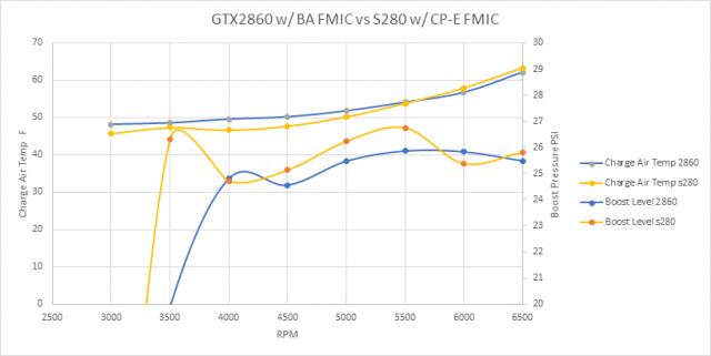

So the whoosh V3 is the same footprint as the CP-E intercooler (which I have). I actually looked into "upgrading" to the BA intercooler and looked at some data comparing the two with @CP-E Mitch. I know he doesn't come here often but the gist was that the performance was nearly identical between the two with similar turbos. He convinced me not to upgrade. A lot of the additional surface area of the BA unit sits in a location that does not get great airflow.
Mitch also mentioned that because the GTX2860 is more efficient at higher boost levels, compared to the s280, it likely explains the lower charge temps compared to the s280 rather than the intercooler itself in the below figure. Not an apples to apples comparison unfortunately, but his explanation was enough to convince me that the CP-E (or whoosh V3 in your case) was sufficient.
The below figure is during 4th gear pulls in similar ambient conditions.

Perfect reply, this is also why Mitch is my tuner; he rocks.
I only got the BA because I had an ATP intercooler, which while similar to the CP-E, wasn't as efficient. So I went big, I'll get a crashbar one day and that will help with the flow, but for now I have never seen over 110* in 90* ambient temps on any pull.

So considering I already have the intercooler. Which one should I sell. Also, I talked with typhoonfist about this, he says he would recommend the ba. I need actual data from someone on the ba to compare, preferably from the same turbo.

Was what I posted not actual data?[confused]

What I'm saying is I'd also like data for the ba on a similar turbo. What you posted was absolutely what I need for the Garrett core intercooler.
