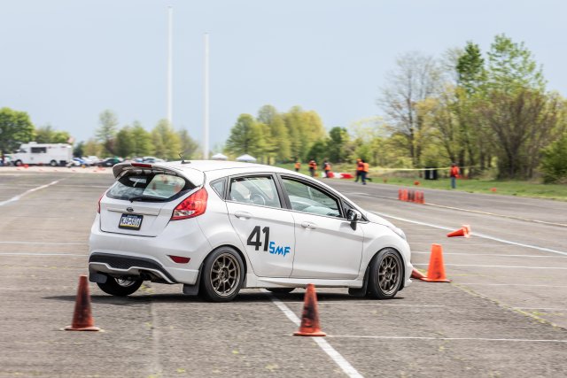

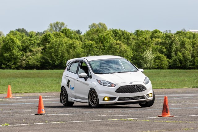

The 205/50R16 (or 205/45R16) tires you are going to run on your 16x7 can be run on a 16x8 dekagram and will arguably perform better due to a small amount of stretch. The correct answer is dekagram.
Seemed like most of what I read said it was a no go and only certain tires that were considered large 205's would work on 8's; both forum posts as well as manufacturer recommended sizing info. Honestly I'm new to the performance car thing and have only ever had turds my whole life. Do you mind going into a little more depth about it?

You are misinformed. Read this thread in full, if you have further questions after reading it - you can PM me. But that thread should make it clear that you can 205/45R16, 205/50R16, 215/45R16 and 225/45R16 on 16x8 dekagrams. They are the best bang for your buck if you want to move down to 16" wheels.
https://www.fiestastforum.com/threads/new-16x8-wheel-incoming-konig-dekagram.15612/

I run 205/50r16 Indy 500s on 16x8s and love them. Barely any stretch and plenty of rubber to protect the wheels. My local big o tires installed them no questions asked. The dekas are lighter and stronger than the rotas
