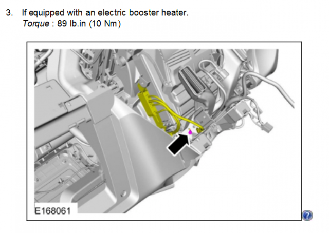

This can be normal for electric heating coils that are getting their seasonal first time use. But our cars do not have electric heat and most automotive heat systems do not restrict flow to the heater core when the heat is off.
Interesting... our cars may come equipped with an electric boost heater...
