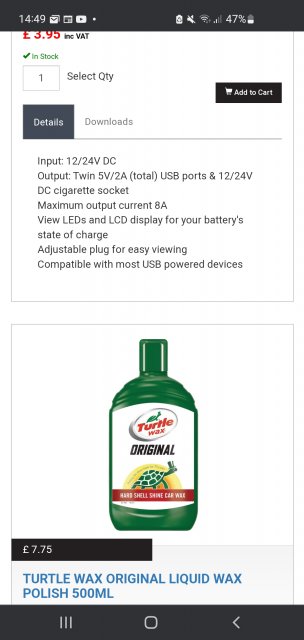

Hi been having problems with car battery dieing so got new battery recently. Seemed to have solved it till a few days ago found car dead again. I left my battery monitor plugged into the cigarette lighter so unsure if this is the cause. I've attached a screenshot of an almost identical monitor specs only difference is mine doesn't charge any usb devices it just monitors battery. It's same brand just that one difference. Could this be the cause if dead battery? Car is 2014 ford fiesta.

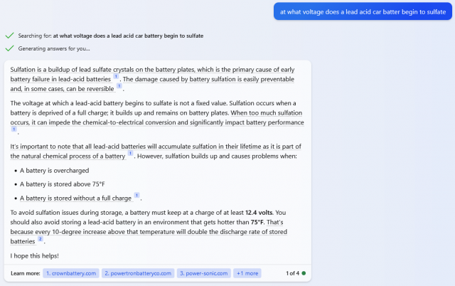

It's not that they will quickly drain the battery low enough that it doesn't crank, it's that they will drop the voltage low enough for them to sulfate more rapidly; significantly reducing their normal usable life span.
