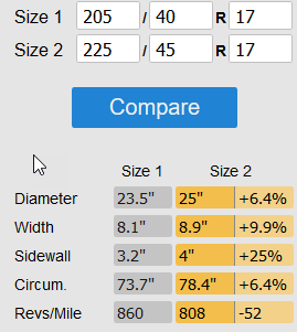

Its interesting how going down to 16" opens up tire size options for these cars. What about the 225/45R17 Rival? Never mind, looking up the size comparison the extra 1.7" of overall height could cause problems.
Tire clearance on width could be cleared with a small spacer, but the height is a potential problem.
