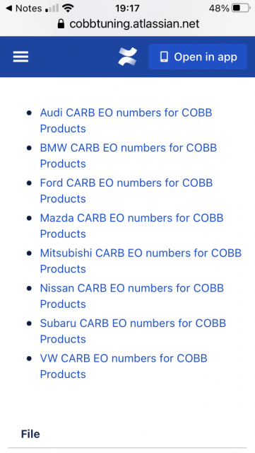

So I did a little research on the Cobb website. It seems that the Carb EO numbers apply only to their front mounted intercooler till 2019 and from 2014-2016 their “stage 1 power package” which includes the accessport/stage 1 tune and intake. So I understand that Cobb says that the tunes are Carb legal, but either their website is not updated or their tune is not legal beyond the “stage 1 power package”
6,192
5,831
#66
my Cobb info came directly from Cobb when it asked to do a firmware update to my AP when I was logged into my Accessport control panel on my computer. Everytime you plug your AP into your computer and open up the control panel software it phones back to Cobb to check for updates. Thats how I found out. This was also last spring when I was tuning all the time.
Mikey456
672
406
Los Angeles
#67
I saw that too. They must not have updated their printed list.
