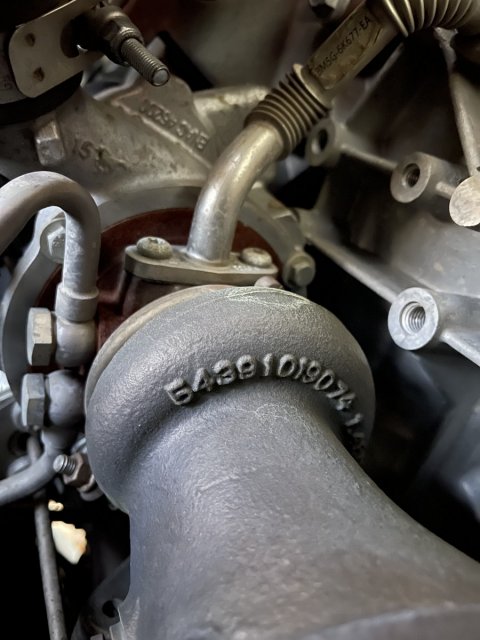

Last night I went ahead and ordered one of the 3" catted downpipes from Whoosh since it sounds like I can swap it directly without messing with anything else. While there I saw their hybrid turbos and wondered if I needed to do a closer inspection. Is there any good way to tell without taking it apart? I would assume the builder would stick there own ID tag or logo on it somewhere. All I did last time I was underneath was look at the part number.
Even at really low RPMs (2000ish) if I give it WOT I can clearly feel the turbo kick in with very little lag time. At any speed a momentary down and up on the pedal off gives a huge blowoff hiss. I wrote that off as normal due to the whoosh valve, but the general feel of the turbo feels suspiciously non-stock to me. Does any of this sound normal?
Granted, apples and oranges, but my usual daily driver for the past ten years has been an F-150 with the 3.5 twin turbo. Insane power once it spins up and kicks in, but there is a lot of lag time (several seconds) before that happens and it is not very obvious until you get some RPM (3000+). The Fiesta is less than a second of lag and super obvious at almost any RPM.

That's the reason people love this car, spool is so quick. If you take off your intake and take a picture of the compressor wheel inside the turbo, that would be an easy way to tell if it's stock or a hybrid. It's tough to see though because of the intake elbow so if you have a small camera or something to put down there that would work.

Switching DP you definitely don’t need to mess with the tune but eventually you’re going to want an accessport anyways I’m sure.
The hybrids use a stock frame so you’d never know it’s a hybrid unless you take off the turbo inlet like Jabbit said above which is a huge PITA. Borescope would probably do it. I have a borescope and a stock turbo lying around. Hit me up if you want to take a peek, I’m just up the road in Carmel.

Cool, thanks guys. I have a long scope so next time I have a chance I'll take a look and post a pic here. If I can't get in the easy way I'll try to take a look when I swap the downpipe.
^^^THIS is the only way to tell without full disassembly. [wink]
