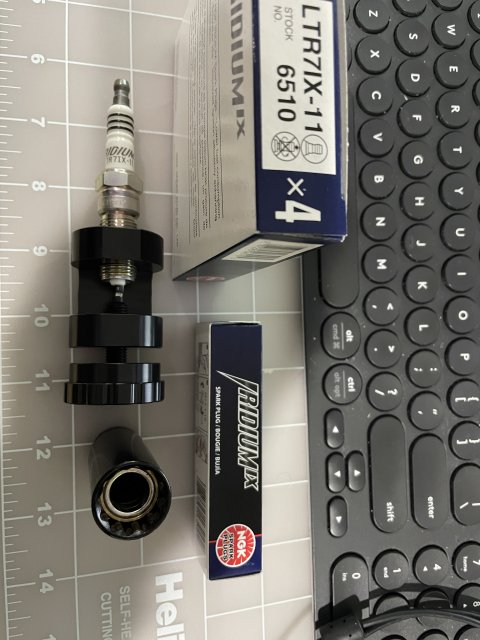

For anyone changing their plugs:
The stock NGK plugs part number is 6509. One step colder plugs part number is 6510.
Spark plugs gap is 0.025 according to SrsBsns, that's what I gapped mine at and it runs fine. Dizzy says gap at 0.028, but that might only apply to his tunes. Other people on here run a 0.026 gap.
NGK says don't use antiseize.
Torque specs are 10-12 ft ibs according to SrsBsns. I've never seen anyone recommend higher than 14 ft lbs. Mine are torqued at 12 ft lbs.
Get a long thin-walled spark plug socket, I promise its worth it!
Hopefully, this will be helpful newbies out there trying to change their plugs.
Get one that is magnetic. The ones with the silicon sleeve have a tendency to age-out and start dropping the plugs. Just dealt with this changing the plugs on a different vehicle last weekend. Went and checked my yet unused thin-wall only to discover it won't hold a plug at all. Had to use a magnet to pull the plugs. I bought a magnetic (non thin wall) just to finish the job.
I'll be looking for a magnetic thin wall.....

Yeah the never used thin-wall I picked up was recommended by someone here. The terminal/cap/bulb on the end of the plug gets screwed off** with some vehicles so it might be just incompatible. Regardless it's going to have the same issue and probably sooner down the line. The other one which is well over 20 years old I had since my first car. I could probably "fix" it but just not worth the time; and have had trouble out of it before. It was past time for an upgrade. ๐Ÿ™‚
