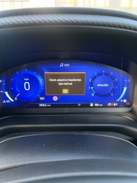

Hi there,
I’m new to the forum. I was wondering if anyone has experienced a warning on their dash saying - Check adaptive headlights, see manual? I have a mk8.5 ST3 Fiesta and I have been troubled with this warning for the past 6 months. I have had the car in at the Ford dealership and I’m being told that there is no issue with my lights. I explained that the lights do not sweep left and right with steering wheel input, while the car is in motion.
I also own a Mk3.5 ST3 Focus. It has adaptive headlights which follow the steering wheel input.
When the Focus is started, you can see the headlights move up and down and left to right. I assume this is self levelling and some sort of adaptive headlight diagnostic.
My Fiesta ST3 does not do the left to right movement and they certainly do not move with steering input while the car is in motion.
The car is due a service in the coming months so, I may try a different dealership to see if I have any better luck with them.
In my eyes, the adaptive headlight function on my car is not working!
thank you in advance 👍

I'm guessing that EPAS/PSCM and BCM have to talk to one another to pull this off. Sounds like the BCM is able to manipulate the headlamps but is not acting on input from EPAS/PSCM. I would ask if this was an option that could be turned on/off in the menu system but the warning message implies that this isn't necessarily relevant. Use https://forscan.org/ to see whether there are any codes present. (make sure the software is compatible with your vehicle prior to purchasing the connective hardware)

Hi Intuit,
Thank you for your reply.
The dealer informed me that they checked for codes but, none were found.
They asked if I could bring the car in with the fault on the digital display but, it is so intermittent that that isn’t really possible.
I don’t understand what is so difficult for the dealership to understand? The adaptive aspect of the headlights does not work.
Thanks again. 👍
