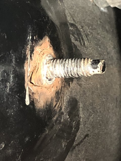

Hi, anyone running a damond catch can ever get this rattle off throttle? Sounds like a squirrel or leaves rattling around but it’s not blower related.
B
57
17
Boston
I think it might be the clips on the coolant hoses or the nut for the catch can mount itself as it’s only on deceleration and just kind of a tap
B
57
17
Boston

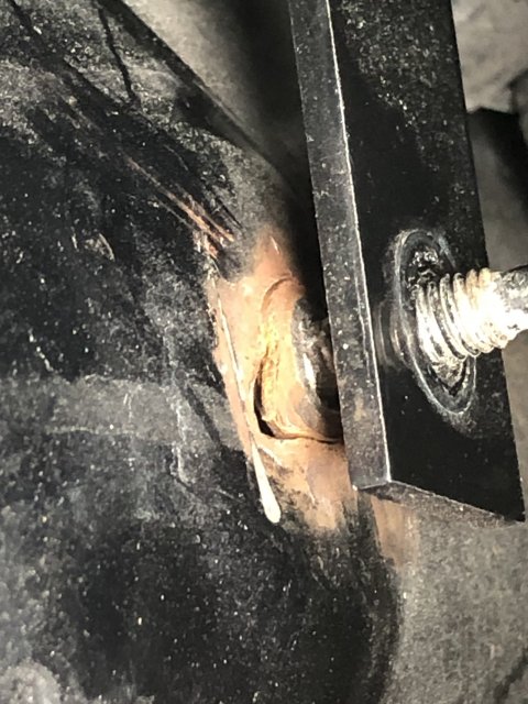

It appears to be the stud the catch can bracket mounts to us loose/cracked. Which leads me to believe it’s the van rattling around. Will either add a nut behind the mount for support or change to a mishimoto can or go back to stock

Man, that sucks. I just put one in and was less than happy with the bracket design. Now really unhappy with it. But thanks to you, at least I’ll know the cause when it starts to make noise. Thank you.

I’m just grateful it wasn’t my turbo bearing being complete shot. Changing to a mishimoto can. Still need to think about the best way to clean up that mess. Most likely it needs a patch welded in and painted over
