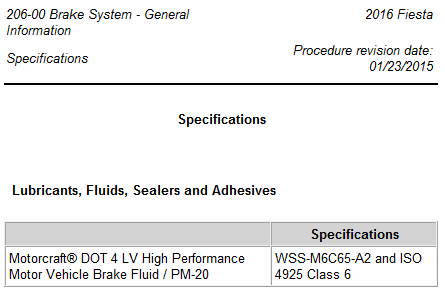

Reminder: Manual specifies Low Viscosity fluid.
https://www.oreillyauto.com/detail/...0724b/pentosin-dot-4-brake-fluid/pnt0/1224116?
May or may not make a difference, but when there are problems with clutch seals and ABS pumps failing, I'd rather stick with what the factory recommends, just to be 100% sure.
I replaced a worn/noisy rack & pinion on a previous vehicle and logically used power steering fluid. When a seal blew not long after replacement, I then happened to notice that I should've been using transmission fluid. (NOTE: Not meant to imply that thicker DOT 4 fluids are causing premature clutch seal failures.)
