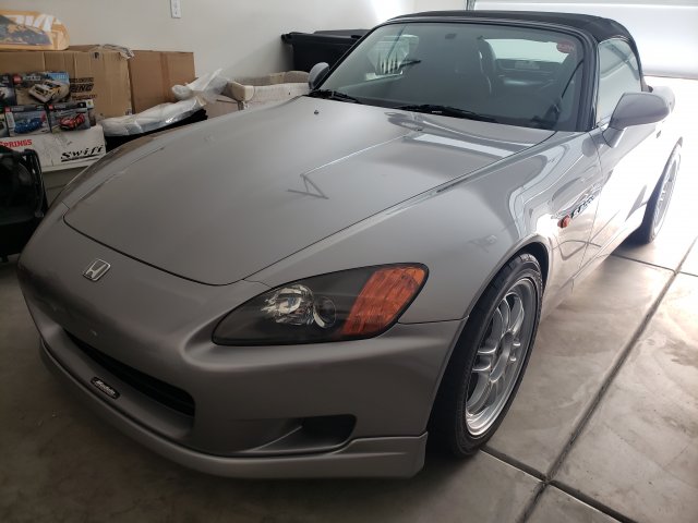

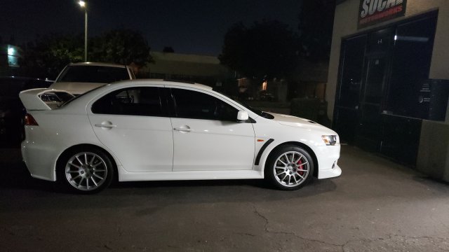

Greetings everyone. I currently daily an Evo X which luckily gets to stay in the garage going forward. I also own an S2000 and my wife drives a 430i gran coupe. The evo and S are low mileage and will be weekend cars. I recently received a promotion and will receive a car allowance. The Fiesta ST looks like the most damn fun a man can have, especially at the used price point. I also love the idea of having some more utility and better mileage (tuned evo eats gas like a monster, even outside of boost). Does the Fiesta accommodate a baby seat? Any huge issues I need to look for? I would love to find one with the recaros. I'm not skinny, but the evo recaros fit me okay. I've also read to buy MY16 and above. Is that true? There's a nice 2015 white one with low miles near me. At any rate, I look forward to test driving one and hopefully joining the jelly bean crew. Attached some pics of my cars. If anyone has questions about evos or the Honda, maybe I can help out.

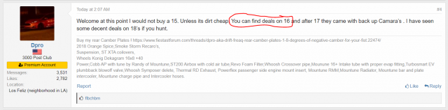

1 yr isn't going to make a difference. a '16 could be treated worse and have higher miles than a '15.
The point I'm getting at is there is no reason to dismiss all '15 & older model years (unless they want specific color or tech like synch 3 or backup cameras like SrsBsns said), especially if it checks all the buyer's boxes and they are doing the inspections that they should be doing for any used vehicle.
