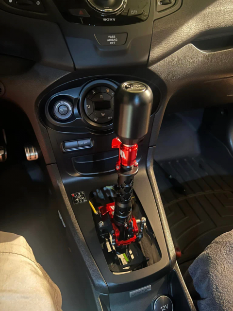

I have and I actually like it's aesthetic. Just that even $500 is a bit much for a shifter imo not that it's over priced at all compared to even other cars. So far I installed am extension and I'm waiting on the little reverse lock out. I definitely like the height. Not as sloppy as I was expecting either so may go with the mountune plate shortly, after a weeks of thought...and research into people who uninstalled the plate lol 1000029292.jpg

I'll probably be installing my mountune plate then later this week. It's been sitting in storage since I bought my Fiesta as I've been scared of reverting to stock but I doubt I'll have to ever revert. In the future I'll probably get the boomba shift lever to complete it, if my extension still makes it feel long. My setup will look like this as Ive ordered the extension from billetworkz after realizing the reverse lock not I ordered is kinda sharp/ugly looking. 1731424770199.jpeg

Installed the mountune plate today. Big difference. Throw is just right could maybe be a bit shorter but I love it rn. The extension makes reach perfect and comfortable, and with the plate it doesn't feel notchy, it feels like it takes a bit more pressure like there's less leverage and I really think it feels better. Maybe some day I'll do the boomba lever too but for now this works awesome! Install took 15 mins. Thanks for everyone's input
