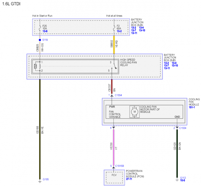

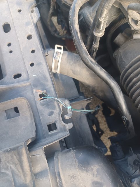

What are these two wires that come off the cooling fan wiring harness? One harness is plugged into the fan. Then I have these two that come off. But can't find what they connect to
4,223
2,761
2016 manual...

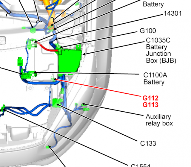

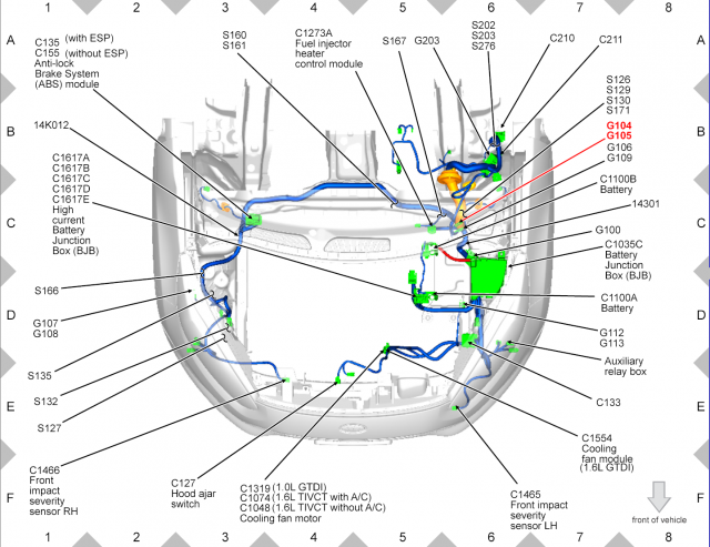

The colors are probably off from the image but both wires appear to go to ground? One from the fan relay and the other from the fan module.
Let me see where these grounds go are at... okay photos posted.
