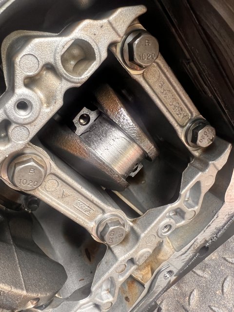

just over 900 miles in on the build, I decided to change the oil. And from that point, it has stopped me in my tracks. After seeing what looked like golden dust in the oil I started pulling the easiest parts that would hopefully give me insight of the issue. Valve cover, oil pan and intake. Turbo... zero play. Cam lobes, also good. Oil pan, nothing in the bottom. I did pull connecting rod caps, but that’s the only bearings I’ve checked. They checked out. Nothing with a bearing shows signs of overheating. And I feel at this point any bearing from here will escalate to other parts needing removed to gain access.

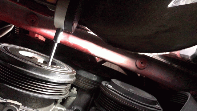

I got to the thrust bearing. And this is where I focused in. I’ve checked All-Data and tried my best to use a dial indicator. With no definitive proof of a reading I would trust.

.... I'm cringing and mostly commenting to follow this thread. It isn't looking good from the picture you provided. The only thing I'd be curious is if you have any weird over travel issues going on with your clutch overloading the thrust bearings. How many miles are on this engine total?

Did you record a measurement of the free play on that dial indicator?
A typical engine (of any kind using light 20-30W motor oil) with ~50mm bearings should have ballpark between 0.0015” and 0.002” on both the journals and the thrust bearing. Total play could be 2x that if you rock it back and forth at rest. If it’s significantly more than about. Even accounting for wear and measurement error, if you’re seeing total back and forth of more than about 5-6 thou, something is wrong. If it’s within that range, it’s probably (but not definitively) okay.

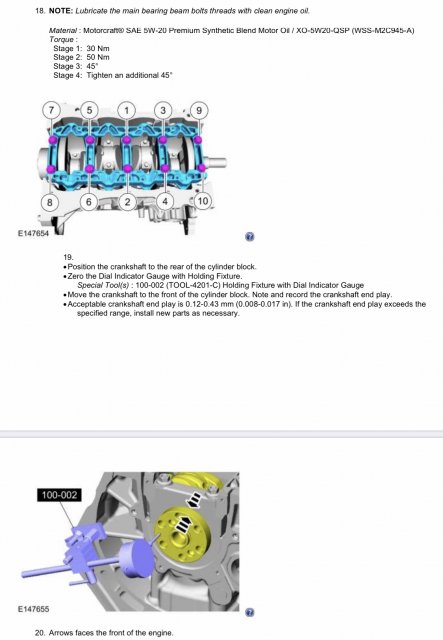

Edit: my math is good for round journal bearings but thrust bearing is allowed more play as shown in a post below (8-17 thou)

Looking at that video you posted you are getting roughly 1/32 inch of crank walk. That is way too much, it should not be visible at all. I suggest that a complete tear down of the short block is in order. As for the cause, it's a pure guess but I would be looking at the serpentine belt tensioner and the alignment of every pulley. Internally a close look at each crank bearing and each journal bearing may provide a clue.

I will have to double check my measurements. But I was getting .013-.017in on any given push with whatever 5-30 oil film is left on the bearing and parts surfaces. 938EDA5D-C633-47AC-BB53-C4A1469C1C24.jpeg
