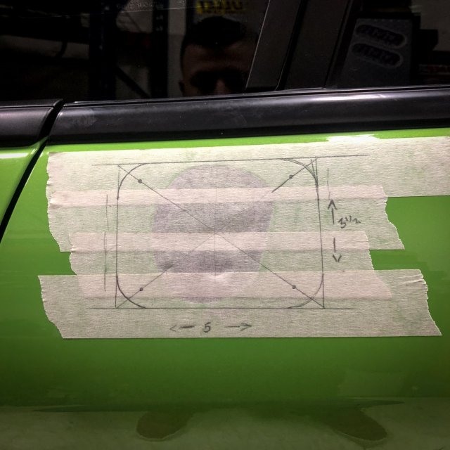

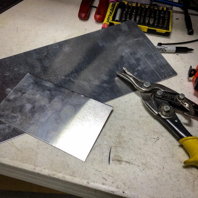

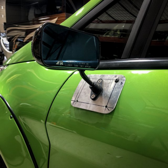

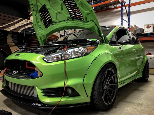

I don’t have the attention span or dedication to make a complete build thread but figured I should start to post some of the modifications to the FiST as I complete them. Might spark some new creativity in the community.
I’m not super happy with how the mounting plates turned out. The original plan was to fab them from some 2mm carbon plate but that proved to be too stiff to fit the contour of the door. I will try painting the aluminum plates black and source some black hardware and that should make it less of an eyesore.
My fiesta is track duty only so before the flaming please take that into consideration. I’m pretty sure this shaved around 6 pounds total or approx 3 pounds per mirror. I will have to weigh one and update.

I think you would be better off shaving down the oem attachment portion and building into that.

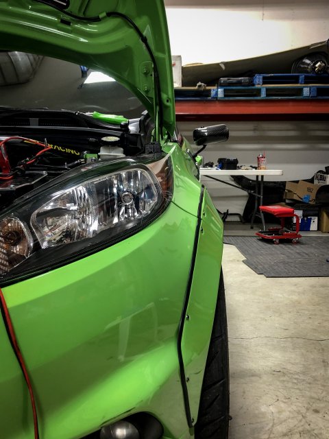

Was able to get both mirrors mounted over the weekend, and paint the base mounting plates black. It isn’t as perfect as I’d like but for track duty it will work awesome. Maybe over the winter I will do as blurred suggested and shave the oem mirror holes and mount the ape mirrors directly to the door.

I found the mirrors on amazon, tons of places sell the APR stuff tho.
Wheels are Japanese Racing 21’s 17x9 et25 with a 245/40/17
