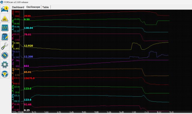

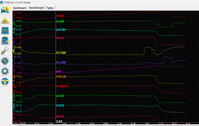

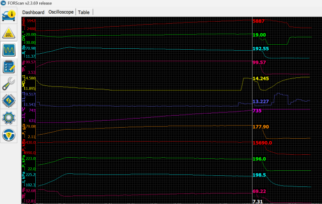

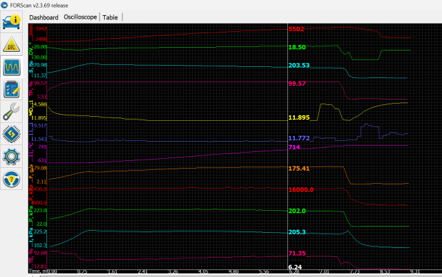

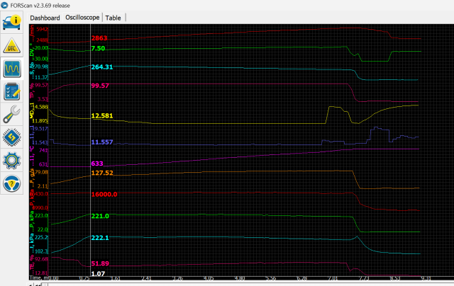

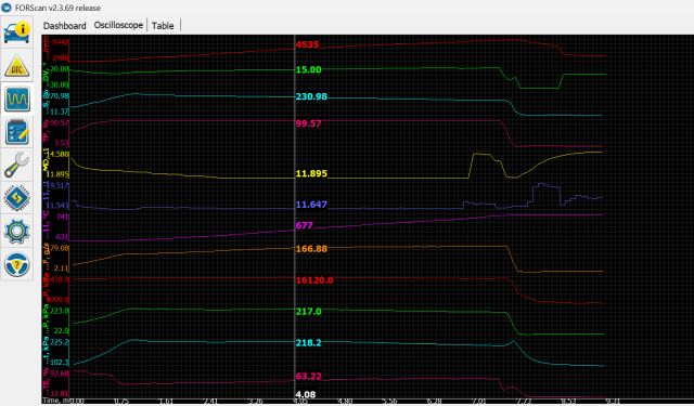

Car not performing at the boost levels the tune should give i.e 1.55bar of boost.
Everything on the car is fine.
Smoke test passed.
Compression test good.
No missfires logged.
All components working as they should be.
My thoughs its there file thats the issue ?
From my knowledge the wastegate duty cycle seems rather low ? and i cant change this with preload on the actuator rod (ive tried) it stays the same no matter where it sits, its like its hitting a set parameter within the software.
Thoughts ?
