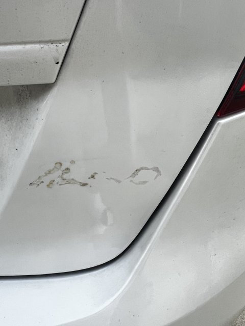

So I was able to remove the other decals but this one. Any recommendation how I can remove this. Looks like for some reason they added glue or something

Use goo gone. That stuff has always worked great for me to remove left over sticker residue. If that doesn't work, get a steamer, thatll loosen up the glue
I guess I'll try that because I tried goo gone and nothing. Steamer the same as a hot gun or no?

Goof Off, you're not going to need much to remove the glue. But I would suggest a plastic razor blade be used when applying the goof off until you get to bare finish. I've done this several times on the van as I'm prone to debadging things..
Steamer and hot gun are different. Both can work, but the steamer will have the extra effect of water, which make me helpful in loosening up the old residue

eraser wheel has worked for me. and it has worked on some other parts of my car. maybe it pulls some clear coat but i don't know. if anyone has thoughts, please reply to me :p

You may not have actually gotten all the adhesive off. There is often a ridge of hardened, dried adhesive at the edge of the decal which is very difficult to remove. There can even be dirt that got embedded at the edge of the decal that combines with the adhesive to make a sort of concrete. To remove it you have to use your chemical, usually a citrus solvent and try to keep it wet with the glue solvent for a while, like 15 minutes (using a paper towel wetted with the solvent held over the area) to soften the ridge, and then use a plastic tool like a vinyl squeegee or a plastic razor blade (be very careful with the razor blade) to scrape away the ridge of hardened adhesive. This can also be necessary if a decal has been removed but the adhesive not removed immediately.

if there's no sticky left over on the car and you're getting more of a sun fade, you'll prob need a cut and buff to revive the faded paint color.
