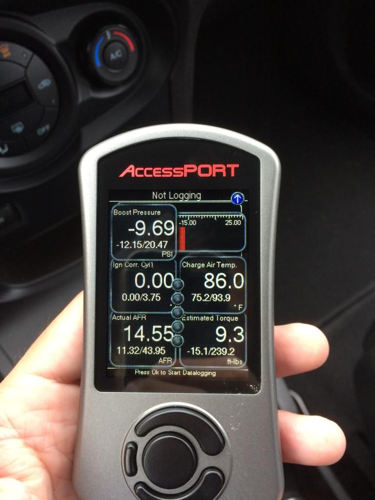

So, I flashed the stage 1 V200 91oct map and kept the AP connected for a little ride tonight. (First second and third have really picked up a good bit) I noticed my boost pressure hitting 18psi in 2nd and hitting 19.5-20psi in third. Outside air temp was 82*F and I was running 92oct gasoline. Seems pretty par for the course for the conditions.

Thread Starter #19
That's a nice feature. I was guessing that was what those were listing. I'll check that this morning.
