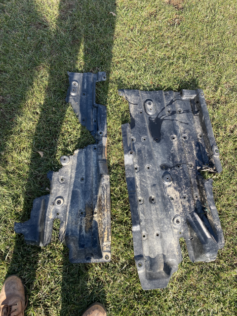

Went to drive the Mighty Fiesta yesterday and heard a scraping sound. Stopped the car and looked under it. Hanging down from about where the passenger seat would be was a piece of plastic. It was easy to tear it off.
Is this something from my car or did did something get wedged under my car?
honestly my first guess is something got caught under my car since that does not look dirty enough to have been under my car the last 3000 miles.
any guesses?

Yep that came from your car. It's a piece of one of the underbody panels used to keep dirt, rocks, and general muck off the painted underside of the vehicle body. You likely ran over something that took a chunk out of it causing the damage you see there. I only have about 50% of mine left from rallycrossing, been looking to develop an alternative for awhile now.

ah thanks! is it something I should be concerned about?

I would just take a peak underneath there and look for the hole. Make sure the remaining cover is not hanging down and the components behind the hole are not damaged from whatever you hit. There are fuel and brake lines under there.

After you posted this , I looked under mine and I have a hole about the size of your fist. And I think mine came from a opossum running out in front of me .

This is actually for sound-deadening... to make your ride a quieter ride.
(But then they go and install a rediculous sound SymPOSER... 😂 ...which I disabled...)
It's also an excellent harbinger of road salt. Keep that in mind when you do your under-body wash.
