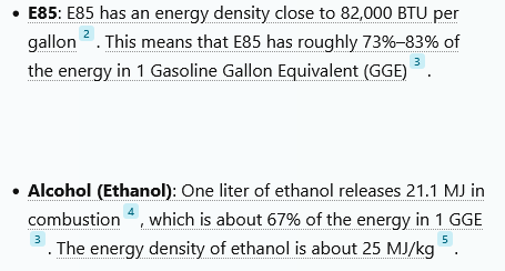

Suspect one of the reasons manufacturers drop compression ratio before adding turbo (supercharger, N²0) is to provide more of a safety margin for not damaging/blowing up an engine.
Suspect the use of lower energy dense fuels is taking a similar approach. Alcohol and E85 are much less energy dense than 93 pump gas. Seems like this would allow one to more finely tune (control) the explosions.

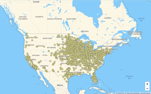

The only bad thing about Ethanol is availability. In my local area there are quite a few stations that carry it. Going on a long road trip, that's where the logistical headaches start. If I go to Southern Ca, it's not so bad. I just have to detour off of I-5 a few miles to get fuel. Go East into Nevada and through Utah, the headaches begin. Other than that, the cooling properties and the high octane of Ethanol are great. Screenshot 2024-01-21 at 15-59-02 Alternative Fuels Data Center Ethanol Fueling Station Locati...png
#4150
14,813
7,272
Wow, do they actually disallow E85 to be sold in Utah and Montana??
