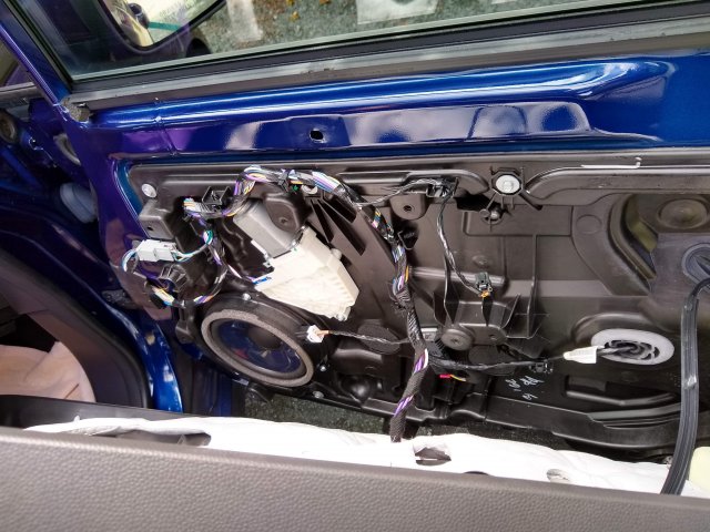

I have a picture of the passenger door of my '16 with the door card removed, showing the mechanisms behind it. Would it be helpful for you to have a picture of that? If so let me know and I will post it.
I would love to see it
