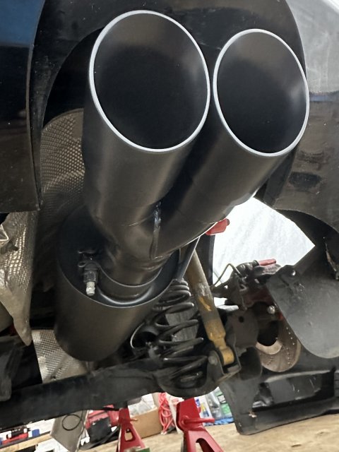

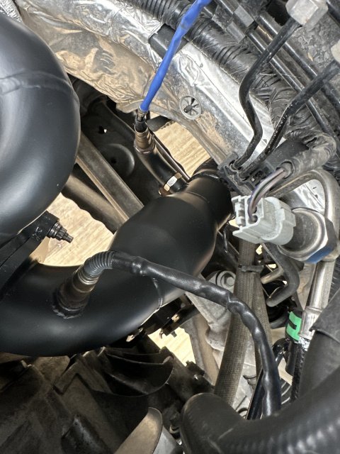

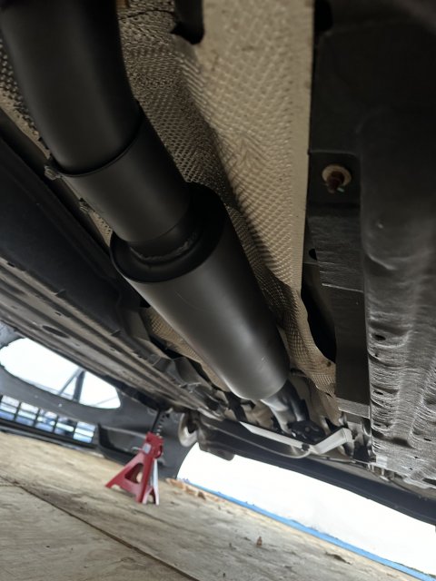

Whoosh thermal here Cerakoted with whoosh catted downpipe and airtech tubular manifold. Absolutely love it!!!! Main reason i had it all coated is for environmental protection. The north east isn't exactly nice to exhaust systems.

^^^POIFECT!!
I wish I would have done the same to my whole CP-E Nexus system before installation way back when I bought it (the Thermal for our rides was not even a gleam in their owners' eyes yet at that time! [:(]). [wink]
