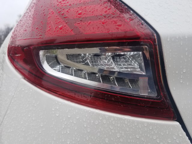

i just went outside and took a pic
its been raining all night and now changing to snow flurries.
no condensation in the clear area, its random like i said.
it happens in that clear area, but last few weeks with rain and stuff and nothing lately.
i just wiped it with my hand to take a pic. View attachment 36494

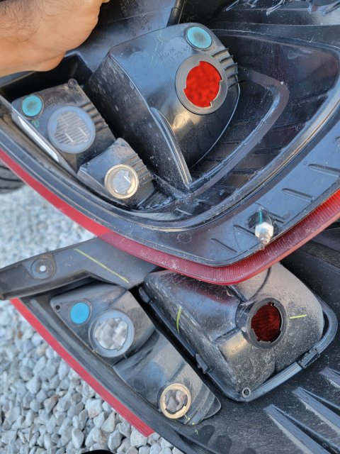

Is there a gasket to cover the access hole In the back? I know my Spec-D's didn't have one and continued to get moisture in them. so I fashioned my own gasket...Been a couple of years now...No issues whatsoever! Look great still too!
129
133
Portland
There's a very thick closed-cell foam seal around the opening for the housing.
I learned my condensation/water intrusion issue was because the harness was in the way of the seal and didn't let it seal all the way. I removed the taillights and pushed the harness into the taillight housings and "fluffed" the foam back up where the wiring imprinted on it. I thought I had a picture but all I'm trying to say is that it actually does a decent job once everything's just right. PNW rain storms and carwashes haven't caused another problem yet.
