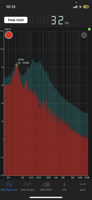

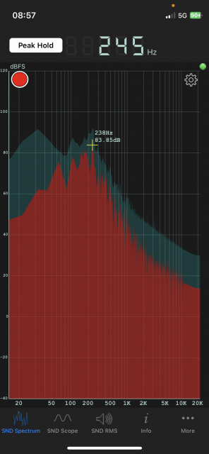

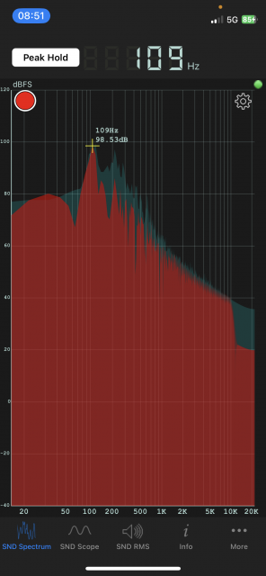

So I was fooling around with a spectrum analyzer app for my phone called “Sonic Tools” and got some interesting measurements of the primary frequency on the Flowmaster “American Thunder”. These are taken inside the car, sitting in the driver’s seat
Idle: 32 Hz @ 82dB
Frequency increases pretty linearly with RPM.
At some RPM some ~200Hz tones creep in especially with a little gas pedal, and sound level rises to about 85dB but that also includes road noise, which was pretty loud on that particular stretch of road on BFG rivals which are kind of noisy anyway.
Right around 3300 RPM, as it passes through 107-109 Hz, there is a very brief spike that depending on throttle position and gear reaches 90-98dB, and then subsides, which I would guess is your drone frequency.
The good news is that the “loud” RPM range is very narrow, as it starts to rise above 90dB above 3200 and subsides below 90dB before 3400 RPM, so you have to hold the car almost exactly at 3300 to get the drone, which is above most cruising speeds not the very broad 2700-3200 as mentioned above. 3300 in 6th is 84mph, so unless you cruise well above 80, it’s tolerable and you can still carry on a conversation without raising your voice.
We’re talking aftermarket exhausts which are obviously louder than stock, but the closest factory comparison I could find is a Porsche GT3 on the loud end at cruise is ~80dB, and new cars since 2016 (in the EU) are supposedly limited to 76dB interior noise at cruise.
I’ve not tested exterior noise, or interior noise at “full send”, but I found an obscure federal code that says new cars when revved in neutral at the engine speed equivalent to peak horsepower should not exceed 90dB interior noise. 🤣
Link to app - I’d be curious how other exhausts compare

^^^ They supposedly, somehow (without using a 20" foot long resonator, as some have suggested is necessary) got the 'bad drone frequencies' out by using a 'correct' Helmholtz device inside of the back box. [dunno]
