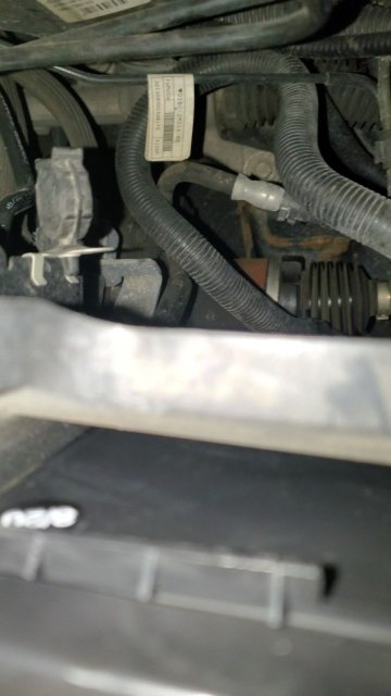

Hi guys,
Thought I'd share, I had my master slave replaced at a mechanic and when I got it back there was a rattle around the dash area I was hearing on low speeds which went away after going more than 20mph. The mechanic wanted to charge me $200 to use some fancy sound detector to pinpoint it. I ended up looking behind the battery and sure enough there's an empty clamp with a hose hanging below it. I reattached it and no more rattling!
Hope this helps some of you out, because I searched online and no one mentioned this as a possible solution.
