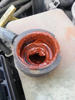

I think it's way more than just the coolant level sensor. There's a thread here that details everything that is done. It's something worth considering.
In terms of service personnel screwing stuff up, that occurs even with oil changes and topping off coolant.
(mixing incompatible coolants)
how old is that picture? and what was in that tank? looks like radiator
/block seal to me
