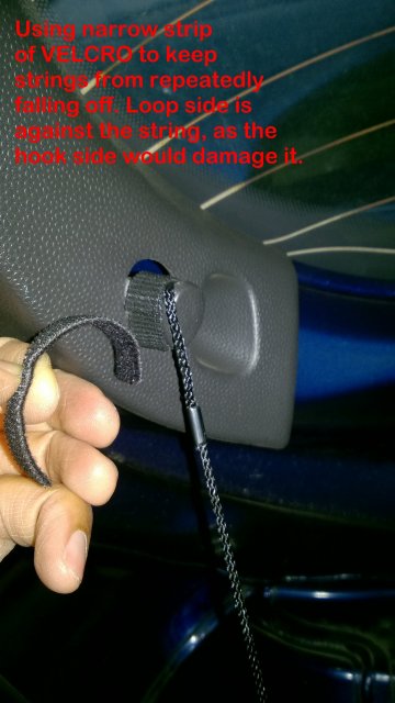

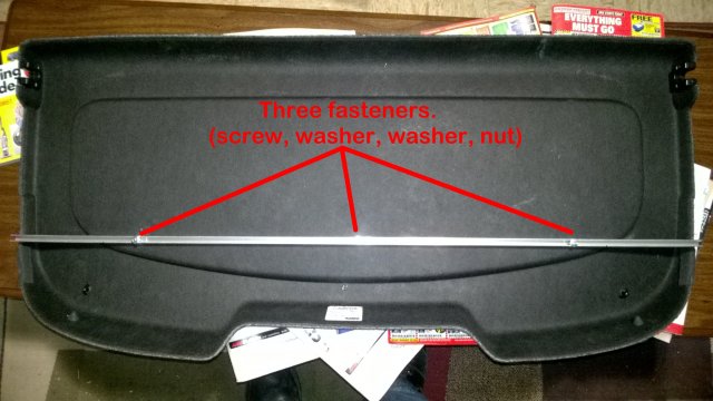

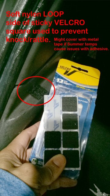

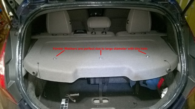

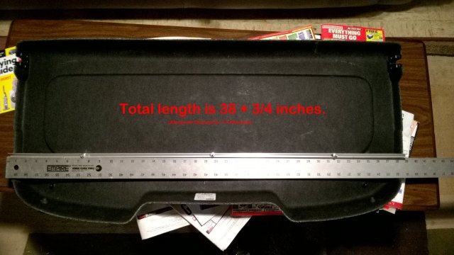

It's not freak'n PRO like @sonicmn (https://www.fiestastforum.com/threads/fix-for-sagging-shelf.19513/post-339718), but I can check one more annoyance off the list.
(high-res photos - click on the photos -or- the link below for full size images)
https://1drv.ms/f/s!ABsZJDCN8kMMgaxh
