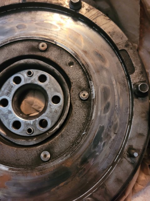

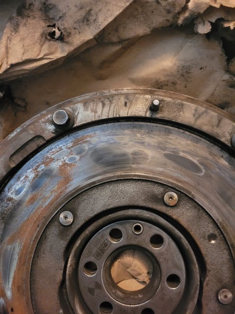

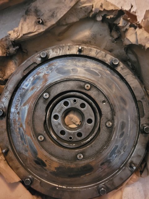

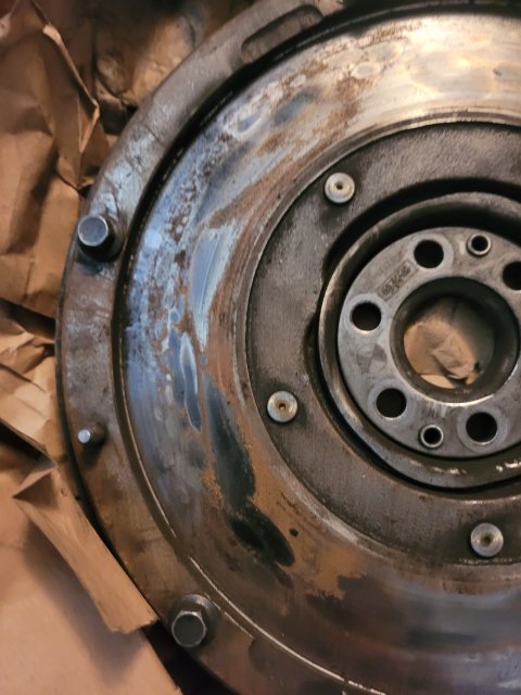

Can you tell if my current one is ok??
CarFan1979
4
Ohio
At first glance that looks burnt up and in pretty bad shape - the dark ovals are heat marks where the flywheel got very hot (potentially red hot). Good odds that flywheel is toast - warped and not reusable. 🥺

Good rule of thumb is that the clutch surfaces are functionally very much like brake rotors/pads. If you saw a brake rotor looking like that, you’d probably replace it straight away.
