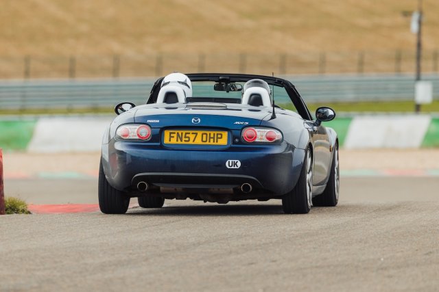

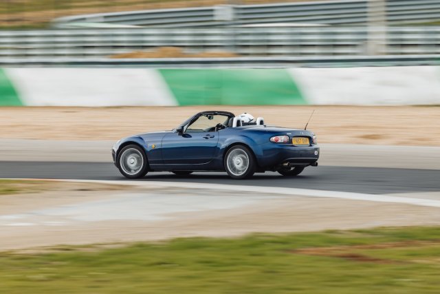

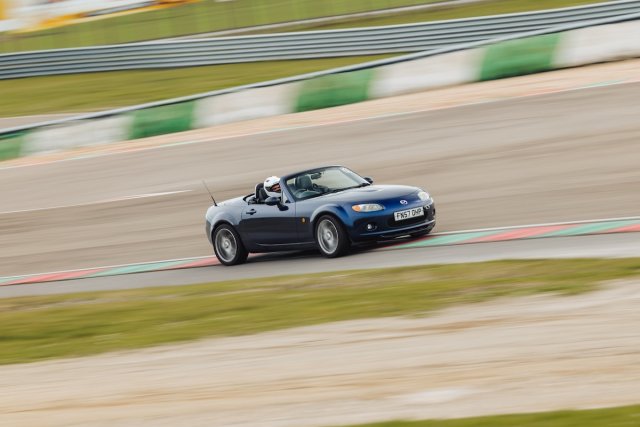

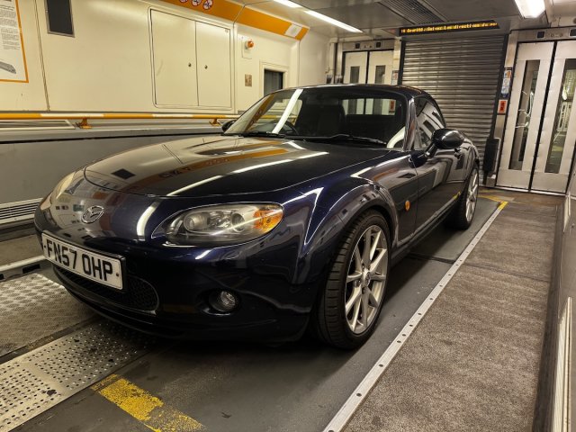

A few weeks back I headed over to mainland Europe for a track day in Belgium and some TF action with Hawyee. I was indecisive about which car to take, but ultimately decided on the MX5 as it was supposed to be freezing with snow and somehow the MX5 seemed like the safer choice.

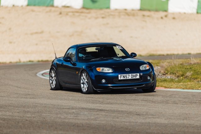

Took the Eurotunnel over to France and drove down to Belgium. The next day was the track day at Mettet Circuit which turned out to be one of the most fun days I've had. The circuit was such a blast and the vibe in the paddock was really good. The MX5 blew me away with how good it handled on track - I knew it was going to be good, but it surpassed any expectations I had! Hawyee took the BRZ which was clearly the better car, but for £1000 the MX5 held its own.

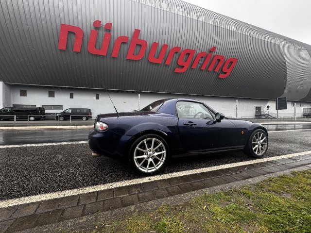

I made the mistake of putting the finest Chinesium pads on the back thinking it would be like the Fiesta where the fronts do 90% of the work, but I completely cooked them in a single day. I had to message a few places by the ring and get them to order me in some. On the following day I drove about an hour north of the ring to collect the pads and had them fitted at Crown Performance. It was snowing the whole time which didn't fill me with hope for TF the following day.

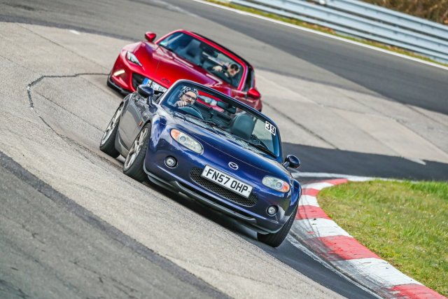

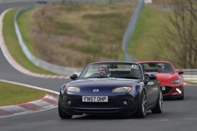

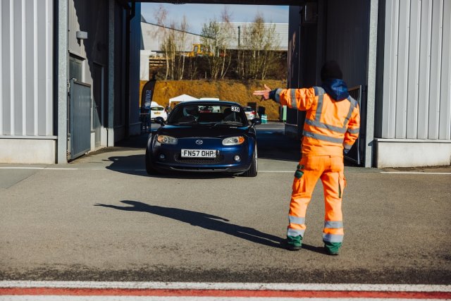

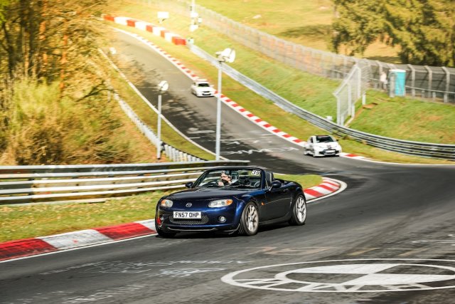

The next morning it was freezing and snowing on and off. The track was supposed to open at 08:00 but didn't until after 09:00. The weather cleared up and turned out to be a glorious day. I ended up doing 11 laps that day and was really starting to build some confidence, particularly in the second half of the track.

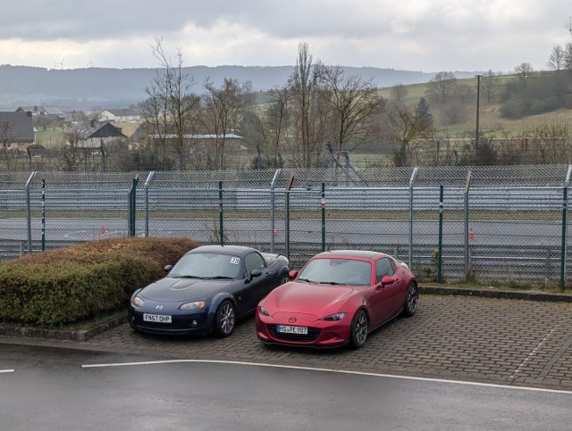

Hawyee brought his ND MX5 this time which was a better match for my NC, but still had way more straight line speed. Driving the Nordschleife with the top down is an incredible experience and I'm debating whether to take it in May when I go back.
