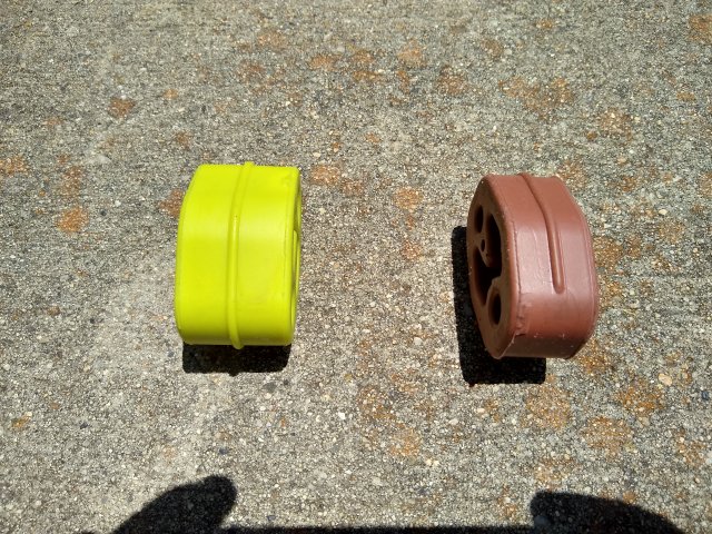

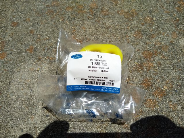

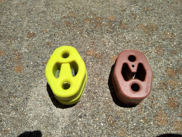

OE look. Stiffer and wider than factory parts. Not in US parts system must order out of UK. Could probably source something similar from US Ford parts catalog if you had access to inventory to compare but these are proven to work. Disappointed at first when I saw how wide they were compared to stock, but after install could see why extra width is a plus. They just fit on the hangars, there is NO lateral movement. As per Mountune, 2 at backbox is probably all that is needed, but I swapped out all 4 with no increase in NVH. Downpipe flex joint is probably getting an extra workout though as the exhaust itself no longer moves.

Harder, poly-type hangers, in original or longer are available all day long on Slamazon for much less money. Your call. I have the hard ones from amazon.

$8.99 each shipped to your door available in 5 different colors including yellow
exact OEM size hole center to hole center. Harder durometer than Powerflex yet softer then the shorter Torque Solution and COBB options
I used the OP's hangers on my first 2016 Fiesta. They are nice and are original equipment on the MK2 RS in Europe which is why it's a FORD OEM item. I also paid $20 each from Mountune plus shipping when they stocked them here in the USA

Yeah, an expensive option but wanted the OE look. Anyone done something similar with US sourced parts?

I used a couple of these Subaru WRX/STI OEM exhaust hangers on mine and they were absolutely perfect. For for $0 from my local Subaru Tuner who was checking out my exhaust. They can be found pretty cheap too online if you're desparate
