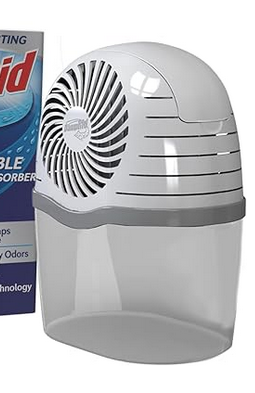

I'd recommend buying some desiccant(damp rid) and a holder made for it. The holder needs to let the water drip, so you need a suspended basket with a bucket under it. I'm having trouble finding a photo of the one I use. But really, i empty probably 2-3 cups of water out of mine every few days. It helps dry out your carpet and foam, too. Once those get wet they take weeks/months to actually dry out, which makes the fogging issue linger forever.
Use it and empty it every few days. It makes a huge difference. I'm pretty sure most Kroger's carry the lil thing I'm talking about. I see a lot of desiccant bags but that seems weird. Try not to spill any of the water on your carpet after it's been absorbed by the desiccant.
I put a bunch of heavy rocks in the bottom of my catcher thing to keep it from falling over. I put it behind my passenger seat.
