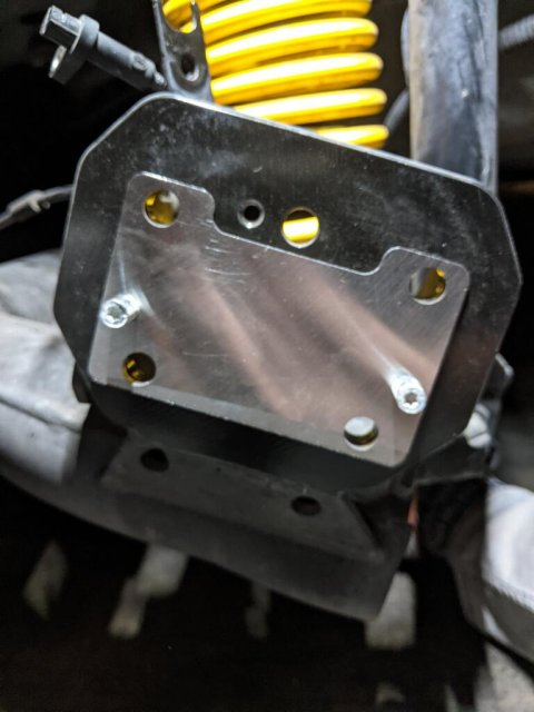

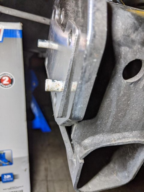

Got mine installed too, pro tip: put some antiseize on the dowel pins incase you ever have to take it apart again, it'll help get it apart in the future if your car has high miles.
