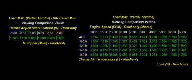

I use 93 top tier only too. It's not JUST the performance, but the fact(maybe?) that higher octane gasses generally have more beneficial additives to keep stuff good and clean, unfortunately not as much a factor with DI. Plus, my commutes are mostly town and see lots of load. That and my OCD. I've logged literally 99% of every mile driven over the last 2-3yrs, even with my old car with Torque Pro. OAR is in the list and hasn't veered from -1.0 since ownership, even with my own "self-tune" with raised OAR sensitivity/response. Look at the difference. Daily driving, average acceleration for me is usually around .5-1.0 load. This table is mostly for extreme conditions (hot days), but it gives an example to what fuel quality does. There are a few tables like this one. oar2.jpg
And don't forget a good synthetic oil, that also plays a part in OAR to an extent. Low quality oils will mist through the turbo under boost, mix with the intake, and lower the overall octane if they're prone to burning.

I use 93 top tier only too. It's not JUST the performance, but the fact(maybe?) that higher octane gasses generally have more beneficial additives to keep stuff good and clean, unfortunately not as much a factor with DI. Plus, my commutes are mostly town and see lots of load. That and my OCD. I've logged literally 99% of every mile driven over the last 2-3yrs, even with my old car with Torque Pro. OAR is in the list and hasn't veered from -1.0 since ownership, even with my own "self-tune" with raised OAR sensitivity/response. Look at the difference. Daily driving, average acceleration for me is usually around .5-1.0 load. This table is mostly for extreme conditions (hot days), but it gives an example to what fuel quality does. There are a few tables like this one. View attachment 26606
Good info. I never thought about using Torque Pro to monitor this.
