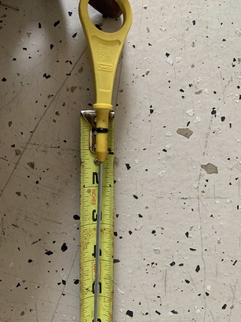

for the sake of science
anyone that's willing to measure their OEM dipstick please post here along with the part number on the handle
the measurement is taken from the Base of the handle to the MAX fill line
we believe but it's not confirmed that the 2014-2017 have one length and the 2018-2019 have a different length. There may not be a clean year change though for part numbers or lengths since our 2017 & 2018 have the same dipstick
thanks in advance for any help on this (y)

2016 PN=BM5G 6750 CA (FoMoCo) other side has PA66 GF30 C9K3A
Base of handle (where metal starts) to MAX =17 3/8" (it's 18 5/8" from where handle seats to valve cover to MAX, as measured by @TyphoonFiST, above).

For the love of God....Here is my 15'
can you give us the PN on the opposite side of the handle?
