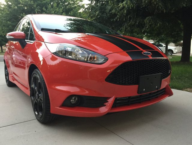

About the ride. I've got a 2016 Ford Fiesta ST. Bought it new and it's been my go to ride since. I love it. It's still stock with no upgrades...and haven't had any major issues with it. The clutch module started to die just a few weeks before the warranty expired and was able to get it replaced for free. WOOT!
I just got a new set of wheels and tires for it. Went from the standard 17" wheels with street tires to 16" wheels with a set of all-season snow rated tires. Thus my interest in this group. The new tires are much bigger than the previous ones and there's less than a 1/2" of clearance. They are tight! It was recommended that I install a lift kit on the car to address this. Has anyone done this? Just need a 1/2"-1" lift.
...and of course, I took it in yesterday to the dealership to have them update the SYNC software. The end-result was a blank screen, but they were happy to tell me that they could replace it for $1100. Suggested upgrades?
Thanks everyone! Happy to be back into the forum scene! 2024-12-06_10-43-12.jpg
