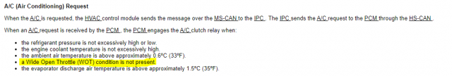

This should answer the question:
That does answer it, good find.
If I overthink it enough though, which is my specialty, it makes me wonder if the A/C is already on and you then go full throttle, will it shut off?
Because on its face it says the A/C will not come on if you are full throttle at the time that you try to turn it on.
Stkid93
#25980
319
149
Ok so if you are wide open, it appears to shut off. However, if you are at part throttle or even 95% throttle. The a/c would still be on. I am really curious to see some numbers. Assuming our car is similar to the Lexus i saw. We are talking about 15-20 horsepower and 40 ish torque.
