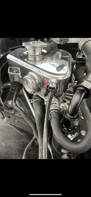

I noticed the same issue as far as the catch can getting in the way when i installed my pro alloy tank but i avoided the issue by slotting the mounting bracket for the tank in the car closest too the front of the vehicle and then putting the mounting bracket on the tank in that slot and then mounted it with metal tie straps. Kinda not what i wanted to do but it works with no issues.

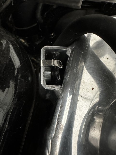

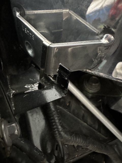

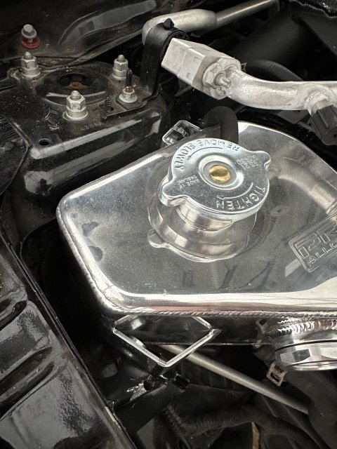

I have this photo ill take more when i get home if i remember too. I dont have any bolts holding this down only metal tiestraps. The back mounting spot wouldnt line up correctly due too me slotting the front mount thus having to hold both the front and back of the tank with metal tie straps. You can kind of see the strap closest to the front of the car in this photo. I also made an adapter for the coolant line going from the tank because i didnt trust the way it clipped into the tank. Just didnt feel right.
