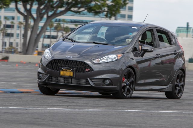

Hey everyone,
Been an ST owner for almost 2 years now. Been a lifelong car guy, drove Miatas, Corvettes, Porsches, Audis before arriving at the Fiesta. It remains to this day the most enjoyable car I've ever owned, and one of the cheapest to boot.
This year I've been breaking it in at autocross and I'm now well into the pack w/ all the other STs (I'm usually the only bone-stock one of the pack). I'm now ready to start modifying the car a bit and figured I could use some more perspective from the broader community. Looking forward to diving in deep w/ yall.

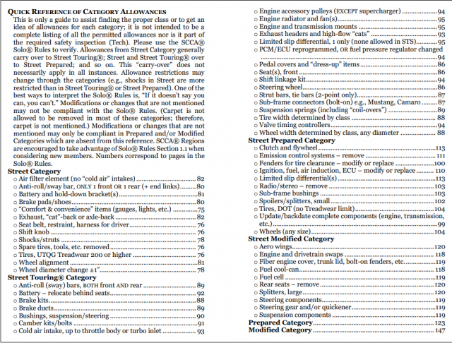

Depends on the class for the mods. I personally don't care about the class and just go out to have fun, but some people care. I can tell you that in STH you can basically do whatever you want with the exception of weight reduction and fuel mods.
HS:
- 16" Wheels
- 205/45/16 RE71r (best thing for time)
STH:
- Mods above
- RMM
- Intercooler
- Coilovers
- Chassis Brace
- LSD
- Accessport
STP:
- Mods Above
- Bushings and Aero
STM:
- Whatever you want

Wow. The rules are a lot more complicated than when I was autocrossing in the 70's and 80's. We just had Stock, Street Prepared, Prepared and Modified. And Street Prepared didn't allow half of what's allowed now.
