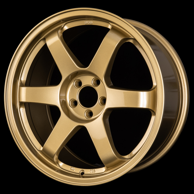

God never any perfect fit bronze or gold wheels okay okay one more than I’ll actually use the website these probably don’t fit but I’d like your wisdom I always hear people say they like 16” on their fiesta
4 PCS ROTA GRID 16X7 PCD:" 4X108"OFFSET:42 HB63.35 GOLD https://www.amazon.com/dp/B07TTVV5RC/ref=cm_sw_r_cp_api_i_m381Eb2SJC752
#10442
287
302
Yeah, those would work. I like a little smaller rim with a touch more rubber (I'm on 15" rims). Going down a size on the rim you'll also need to adjust tire size. The tire size listed below would be what I would use and don't forget TPMS sensors (if you don't rip to stock ones out).
Tire: 205/45R16
TPMS: https://www.amazon.com/gp/product/B0034ROE76/ref=ppx_yo_dt_b_search_asin_title?ie=UTF8&psc=1
New Layout (near match of OEM fitment): Compared to your existing wheel, this new wheel will have an inner rim which is 5mm further away from the suspension strut. The outer rim will poke out 5mm more than before.
https://www.willtheyfit.com/index.p...ct2=45&wheel_size=16&wheel_width=7&offset2=42
