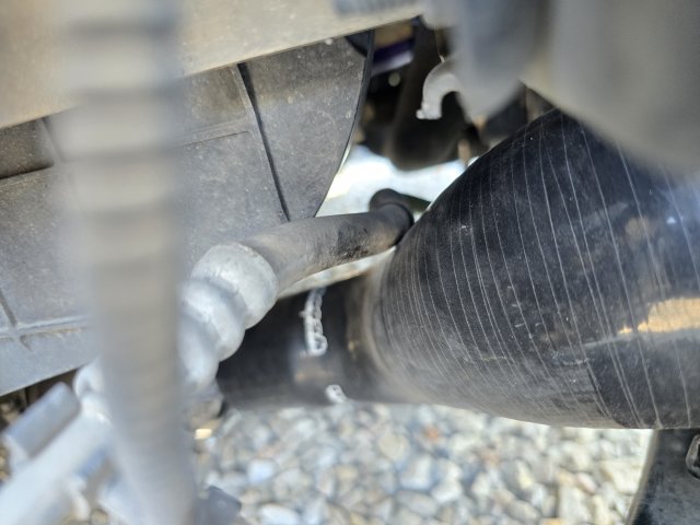

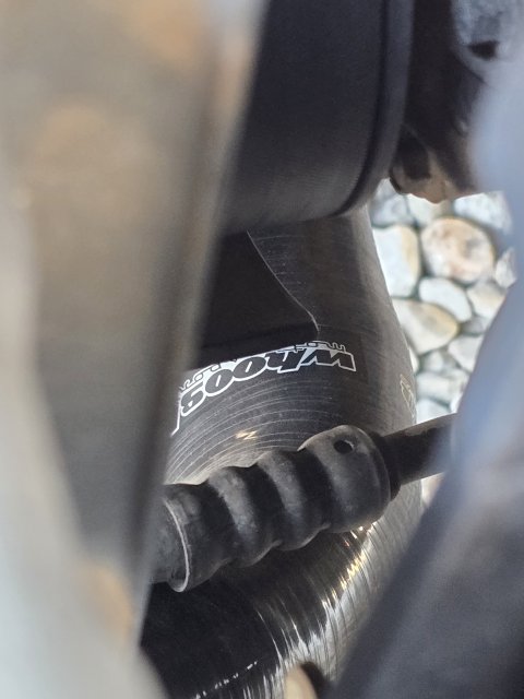

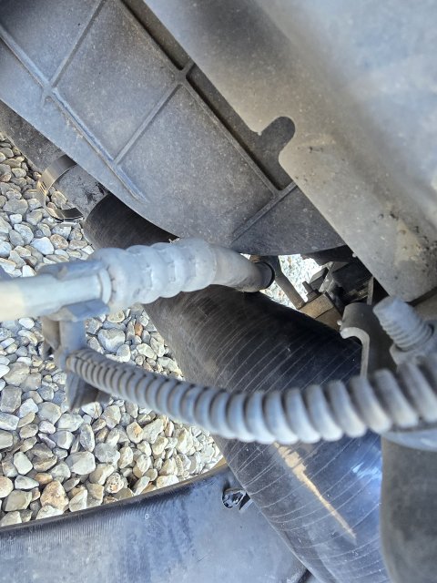

Installing a whoosh v3 intercooler. Went in no problems just had to remove the middle bracket for the splash tray. But now I can't find a way to prevent these two hoses from rubbing. Should I just wrap them up in something?
if you cannot rotate the boost pipe a tiny bit, I would just zip tie them together - even without it, it is a rubber on silicone contact, so I would assume it would take half a century to rub through
