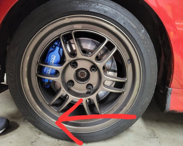

Installed my front brakes per the Whoosh website and several articles I found. Then I looked at the rear. Which is correct and does it really matter?

The second photo is of the correct direction. The vanes act as a centrifugal pump, slinging the hot gas out. It makes no difference on a street car and plenty on a track car.
But what about this picture from the Whoosh website?

I just rabbit-holed. Apparently, some brake manufactures run the slots in the same direction as the vanes, some run them in a different direction. My Wilwood’s have slots that run in the same direction as the vanes, so opposite of the StopTechs. i think that the safe way is to check the vanes and run them in such a direction that they pump air from the hub to the rim. If the vanes are straight, do whatever you want.

You make a good point - the vanes should be throwing air away from the hub. The actual slots on the rotor would be secondary. I'll pull the wheels off this week and verify the cooling vanes are correct.
