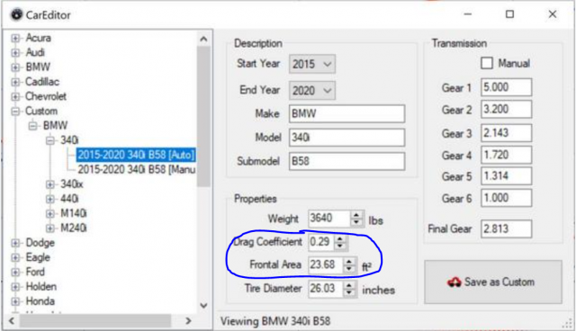

There is absolutely air resistance factored into virtual dyno. Otherwise it'd be useless above 20-30mph. Frontal area and drag coefficient are located in the car setup. If you just chose the default "Fiesta ST", you probably just glossed over it. If you've done any aero mods at all, including silly things like wing risers, it probably won't be quite accurate. Also tire diameter influences the result if you're not using stock wheel/tire size as does vehicle weight.
Below image from random BMW internet forum because I didn't have my laptop handy.
